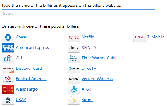

Create an online bill reminder
Use an online bill reminder when you want Quicken to fetch the amount due and due date directly from the biller's site. Enter your login information for the biller, and Quicken contacts the site to keep your reminder current.
  1. Click the Bills & Income tab. Make sure you are on the Bills sub-tab, or, if you have combined tabs, on the Bills, Income & Transfers sub-tab.
  2. Near the top right of the screen, select the + (Add New Reminder) button, then select Online Bill.
  3. Type or select the name of your online biller.

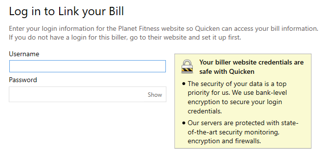

  4. Enter the login information for your online account. It may take some time to process the login and sync the account.
    If an error occurs, check your login information and try again. You may want to log in to the biller's website directly to confirm it accepts your information.
  5. Click Done when complete. Your bill is now linked, and you will receive reminders when the bill is due.

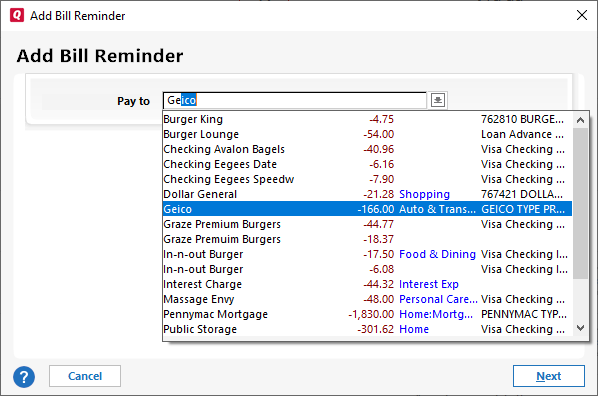

Create a manual bill reminder
Use a manual bill reminder when you want to enter the bill information yourself rather than connecting to an online biller.
  2. Near the top right of the screen, select the + (Add New Reminder) button, then select Manual Bill.
  3. Select or enter a payee. For an existing payee, start typing the name and select it from the suggestions. To set up a reminder for a new payee, enter the new name.

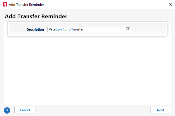

Create a transfer reminder
Use a transfer reminder to track recurring transfers between your accounts, such as moving money to a savings goal or paying down a loan.
  2. Make sure you are on the Income & Transfers sub-tab, or, if you have combined tabs, on the Bills, Income & Transfers sub-tab.
  3. Add the transfer reminder:
    • On the Income & Transfers sub-tab, at the top right, select Add, then Transfer Reminder.
    • On the Bills, Income & Transfers sub-tab, at the top right, select the + (Add New Reminder) button, then Add Transfer Reminder.
  4. Enter a short Description of the transfer, such as Vacation Fund Transfer.
  5. Click Next.

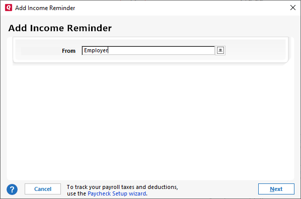

Create an income reminder
Use an income reminder to track recurring deposits, such as a paycheck or other regular income.
  3. Add the income reminder:
    • On the Income & Transfers sub-tab, at the top right, select Add, then Income Reminder.
    • On the Bills, Income & Transfers sub-tab, at the top right, select the + (Add New Reminder) button, then Add Income Reminder.
  4. In the From field, enter the name you want to use for your income source. You can also choose from existing payees.
  5. Click Next.

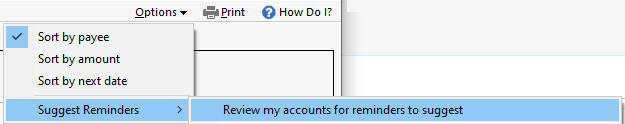

Turn off reminder suggestions
If you do not want Quicken to suggest reminders based on activity in your accounts, you can turn off the suggestions.
  1. Go to Tools menu > Manage Bill & Income Reminders, or press Ctrl+J.
  2. In the Bill and Income Reminders dialog, select Options menu > Suggest Reminders.
  3. Clear Review my accounts for reminders to suggest.
