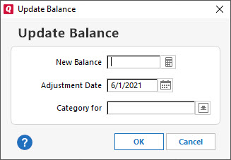

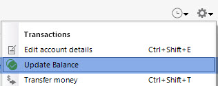

To update a cash account's balance to match the cash on hand
  1. Open the account you want to use.
  2. Select Account Actions (gear icon) → Update Balance.
  3. For New Balance, enter the amount of cash you have on hand as the cash balance.
  4. Enter the Adjustment Date.
  5. Enter a Category for the adjustment transaction.
  6. Select OK.
